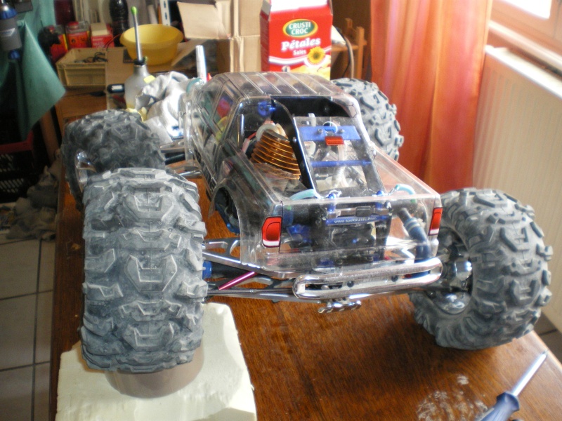

Revo 3.3 Mario - Page 7 Imgp0622
Revo 3.3 Mario - Page 7 Imgp0623
Revo 3.3 Mario - Page 7 Imgp0624
