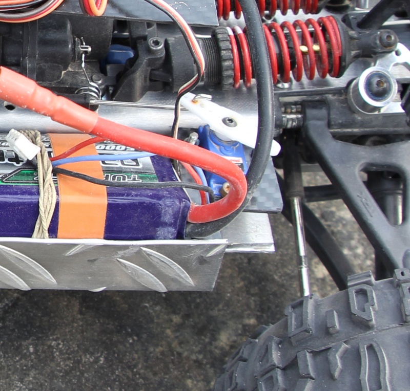

Chassis 4x4x4 made in Tracer:
Summit "LT" P1000910
Summit "LT" P1000911
Summit "LT" Img_0910
Summit "LT" Img_0911
Summit "LT" Img_1010
Summit "LT" Img_1011
Summit "LT" 110
Summit "LT" 210
Triangles de Slayer (A Arm and Links)
2x Savox 1256tg
AE beadlock 2.2/3.0 wheels
Dewalt Motor 14.4V
ESC Mamba Castle Monster
Lipo 2X 2S 5000mah
Custom Chassis 4x4x4 Aluminium by "Tracer"
Pro-line Beetle body (Gun Metal paint)
