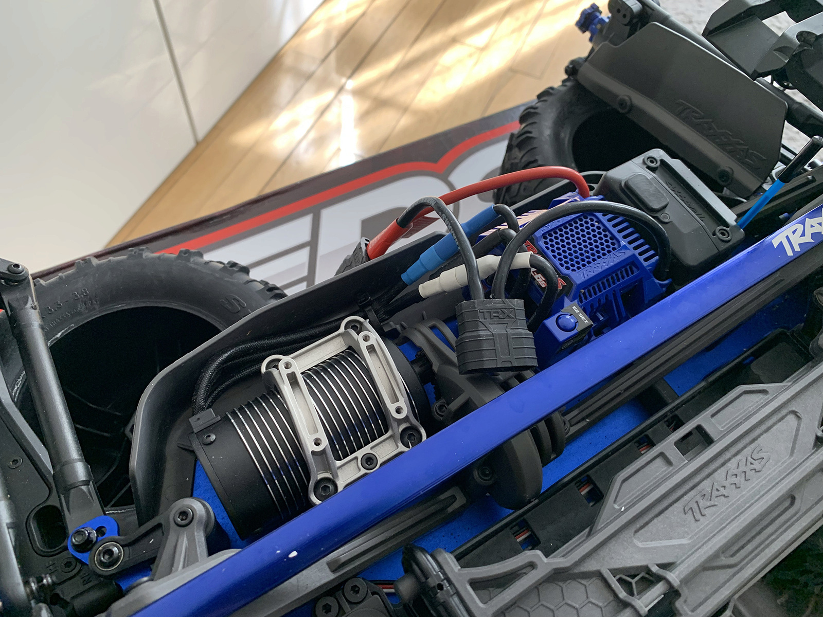

Donc à suivre et pour l'instant place aux photos.
REVIEW SLEDGE TRAXXAS by Chezoit Img_2010
REVIEW SLEDGE TRAXXAS by Chezoit Img_2014
REVIEW SLEDGE TRAXXAS by Chezoit Img_2015
REVIEW SLEDGE TRAXXAS by Chezoit Img_2012
REVIEW SLEDGE TRAXXAS by Chezoit Img_2013
REVIEW SLEDGE TRAXXAS by Chezoit Img_2018
